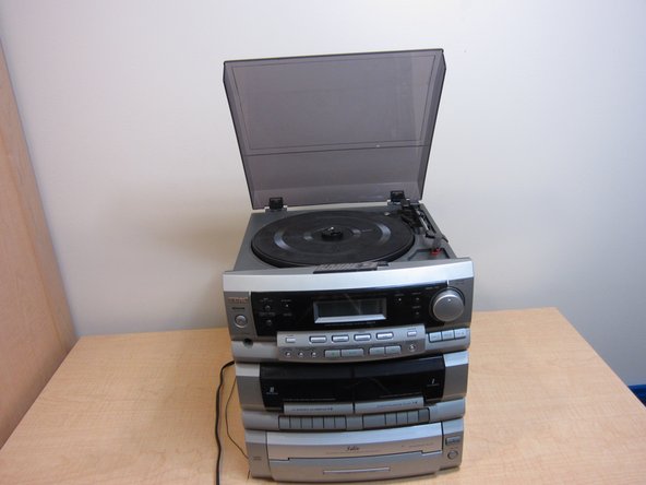

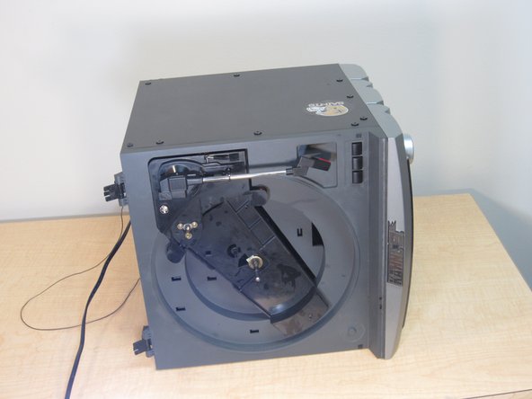

The turntable is operated by a motor that spins a belt and the table. The belt may stretch or become misaligned over time, and may need replacement or adjustment. Note that it is first important to complete the Disassembly Guide.
Image #1 Image #2

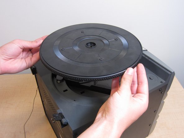

Add Note Edit Step 1 — Belt  ¶
  • Separate the turntable from the top of the record player by lifting straight up.
Image #1

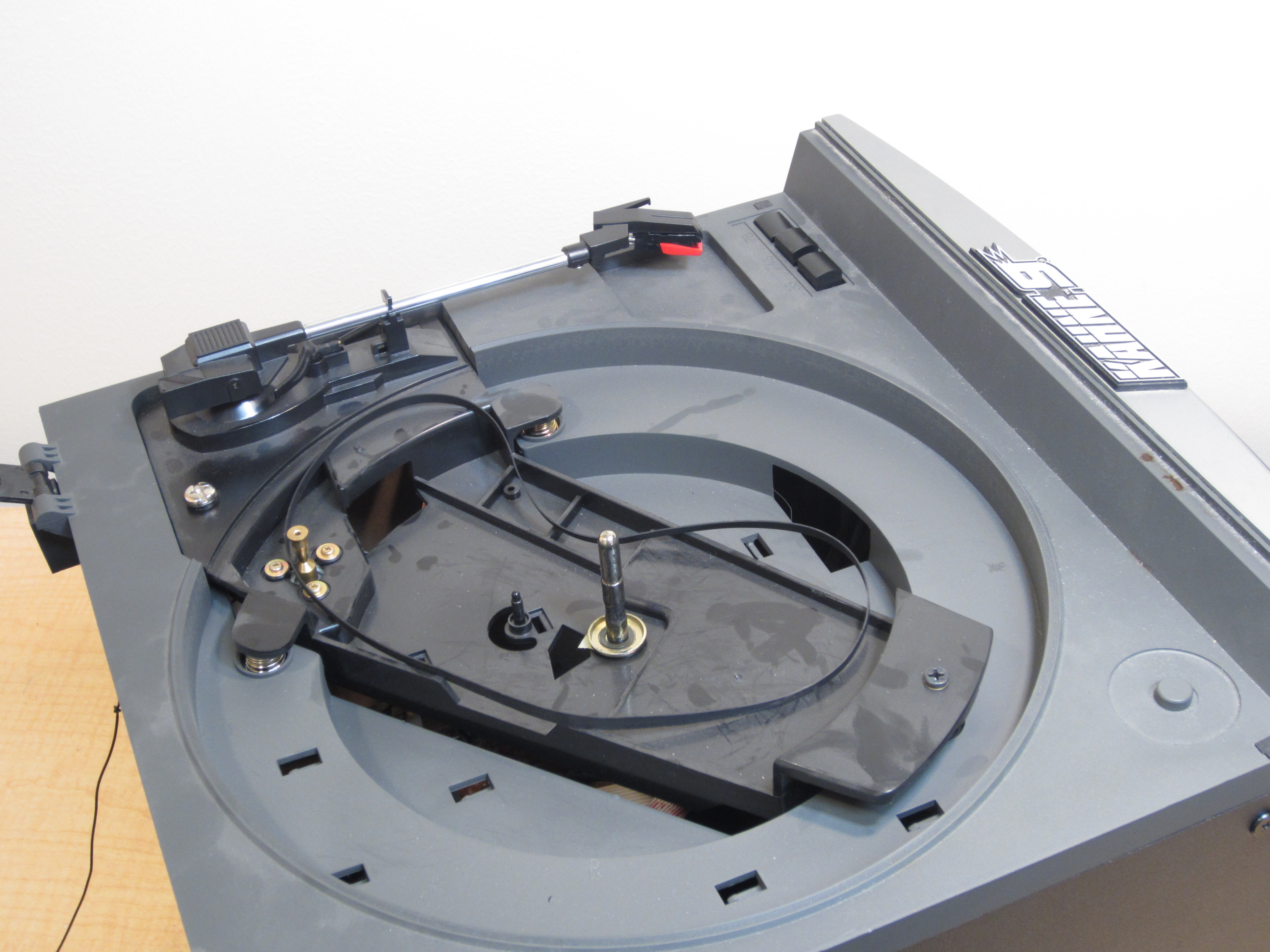

Add Note Edit Step 2  ¶
  • Check the belt to see if it is off the motor or turntable. If the belt is damaged (tearing or lack of smoothness) replace the belt with a new one. If it is off track, realign accordingly.
  • Do not stretch the belt too far as it may break.
Image #1 Image #2 Image #3

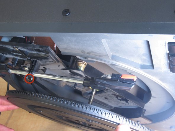

Add Note Edit Step 3  ¶
  • Once the belt is ready to go, re-wrap the belt around the turntable wheel and, keeping it around the wheel, wrap it around the motor (indicated by the red circle).
  • It may be helpful to lay the record player on its side to keep the belt wrapped around both the motor and the turntable wheel.
