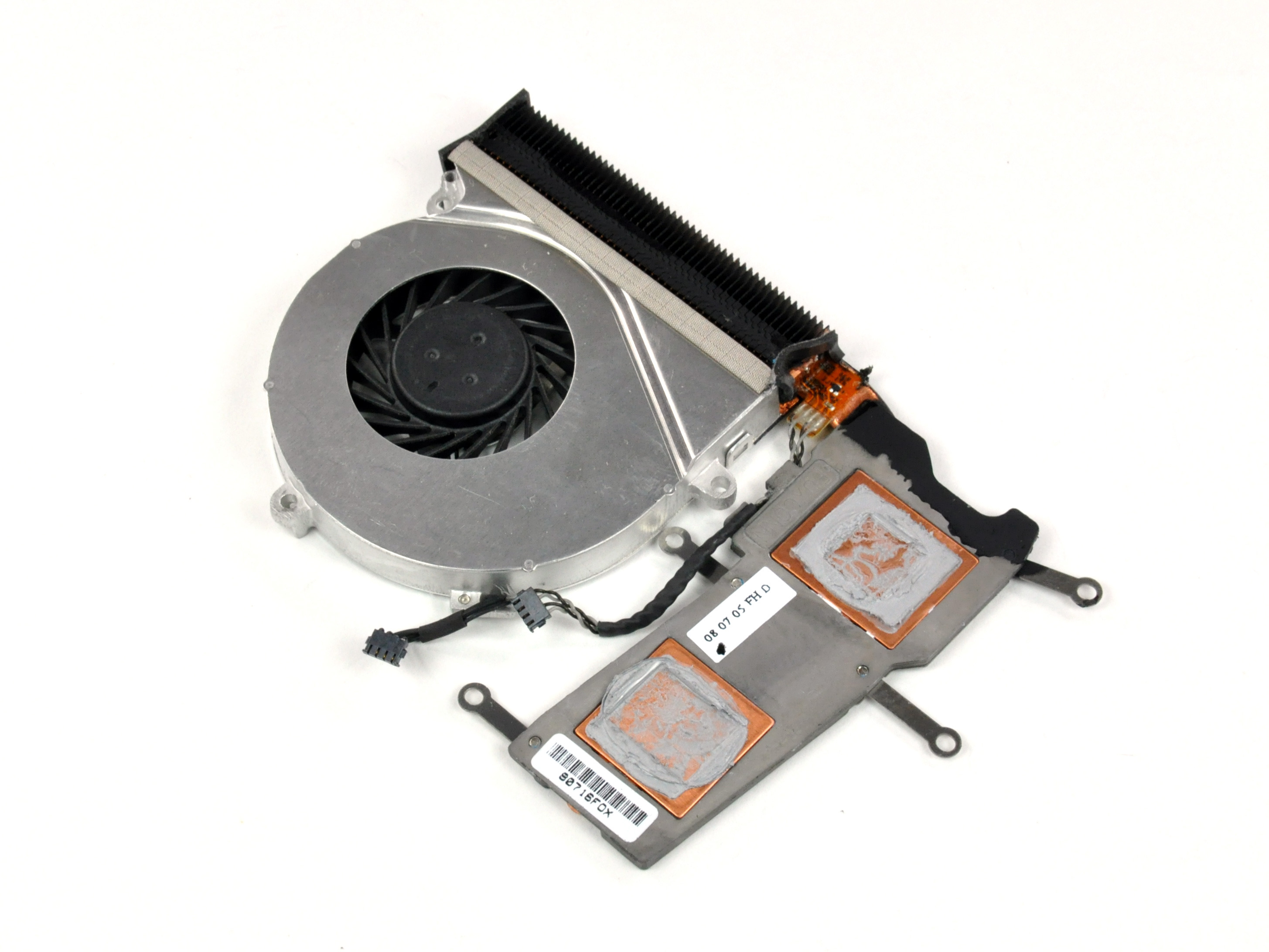

  2. How to Apply Thermal Paste: step 2, image 1 of 2 How to Apply Thermal Paste: step 2, image 2 of 2
    • Use the flat end of a spudger to scrape off as much solidified thermal paste from the copper core(s) of the heat sink as possible.
  3. How to Apply Thermal Paste: step 3, image 1 of 1
    • After scraping off the solidified thermal paste, a residue is still present on the copper core(s).
  4. How to Apply Thermal Paste: step 4, image 1 of 2 How to Apply Thermal Paste: step 4, image 2 of 2
    • Use a coffee filter or a lint-free cloth and a little isopropyl alcohol (a.k.a. IPA, 90% concentration or greater) to clean the thermal paste residue off the thermal contact surface of your heat sink.
    • Instead of IPA, you may also use a dedicated cleaning agent, such as ArctiClean Thermal Material Remover.
    • Once the surface is clean, use a fresh piece of coffee filter or cloth and a little more IPA to remove any oils and prepare the surface.
    • Do not touch either the chip or the heatsink, or allow any dust or debris to get on them. Even a fingerprint can be a major obstacle to thermal transfer on a chip.
    • Allow the heat sink(s) to dry completely!

For heat sinks with a spring on the screws: Wonder why there are springs on the heat sink screws? Do not over tighten them, the springs are there to help you apply the correct amount of pressure on to the CPU and GPU. If you tighten them all the way, it may not be the correct pressure! Leave maybe 1 mm of space, just before the screw stops turning. iFixit forgot to mention this important part, and also in the heat paste guide!!
m3kw - Reply
This is completely untrue. The holes bored in the heat sinks are in fact a larger diameter than both the threads and the shoulder of the heat sink screws. The screws should be fully tightened (as they were from the factory) to maintain correct pressure against the processors.
Andrew Bookholt -
