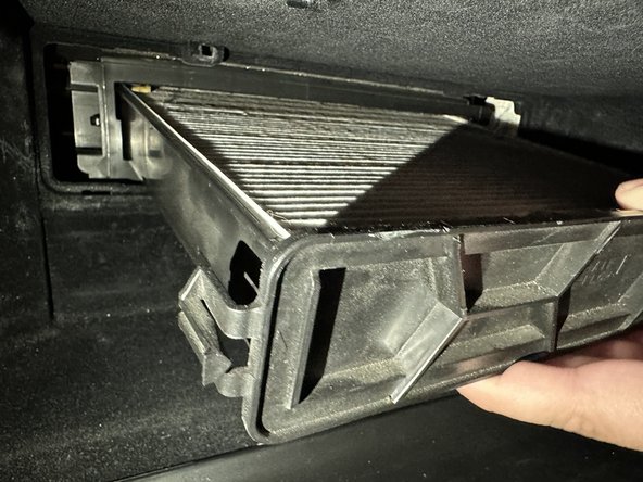

  4. 2012 Acura TSX Cabin Air Filter Replacement: step 4, image 1 of 3 2012 Acura TSX Cabin Air Filter Replacement: step 4, image 2 of 3 2012 Acura TSX Cabin Air Filter Replacement: step 4, image 3 of 3
    • Locate the clips on the left and right sides of the frame.
    • Push the clips inwards and pull until the frame comes out.
  5. 2012 Acura TSX Cabin Air Filter Replacement: step 5, image 1 of 3 2012 Acura TSX Cabin Air Filter Replacement: step 5, image 2 of 3 2012 Acura TSX Cabin Air Filter Replacement: step 5, image 3 of 3
    • Remove the cabin air filter by lifting it.
  6. 2012 Acura TSX Cabin Air Filter Replacement: step 6, image 1 of 3 2012 Acura TSX Cabin Air Filter Replacement: step 6, image 2 of 3 2012 Acura TSX Cabin Air Filter Replacement: step 6, image 3 of 3
    • Discard the old cabin air filter and place the new one on the frame
    • To properly place the cabin air filter, we must align the gaps on the left and right sides of the cabin air filter with the sides left and right side of the plastic chassis.
  7. 2012 Acura TSX Cabin Air Filter Replacement: step 7, image 1 of 3 2012 Acura TSX Cabin Air Filter Replacement: step 7, image 2 of 3 2012 Acura TSX Cabin Air Filter Replacement: step 7, image 3 of 3
    • You are good to go if the filter looks like this first image. If there are still significant gaps on the left and right side of the cabin air filter, proceed to correctly fit the cabin air filter onto the frame.
    • Finish by placing the new cabin air filter with the frame together into the car.
