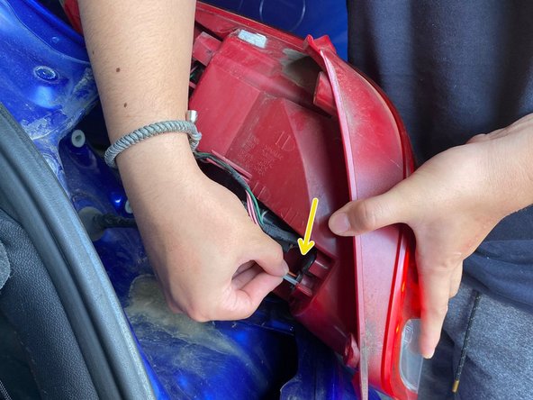

  2. 2011-2017 Hyundai Veloster Back-Up Light and Brake Light Replacement: step 2, image 1 of 3 2011-2017 Hyundai Veloster Back-Up Light and Brake Light Replacement: step 2, image 2 of 3 2011-2017 Hyundai Veloster Back-Up Light and Brake Light Replacement: step 2, image 3 of 3
    • Using both hands, carefully pull the brake & tail light off.

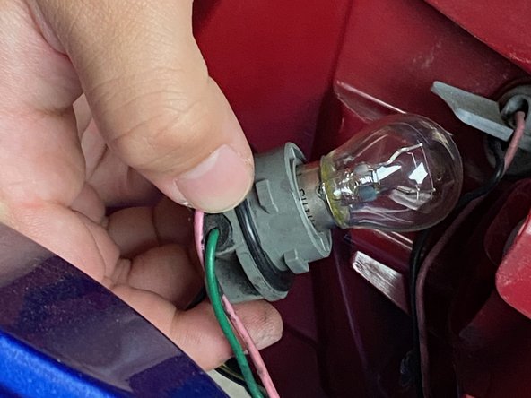

  4. 2011-2017 Hyundai Veloster Back-Up Light and Brake Light Replacement: step 4, image 1 of 3 2011-2017 Hyundai Veloster Back-Up Light and Brake Light Replacement: step 4, image 2 of 3 2011-2017 Hyundai Veloster Back-Up Light and Brake Light Replacement: step 4, image 3 of 3
    • Twist and turn the backup light to the right. And then pull it out.
    • Make sure not to touch the surface of the light bulb because it will break the light bulb easily.
  5. 2011-2017 Hyundai Veloster Back-Up Light and Brake Light Replacement: step 5, image 1 of 3 2011-2017 Hyundai Veloster Back-Up Light and Brake Light Replacement: step 5, image 2 of 3 2011-2017 Hyundai Veloster Back-Up Light and Brake Light Replacement: step 5, image 3 of 3
    • Twist and turn the brake light to the right and pull it out.
    • Make sure not to touch the surface of the light bulb because it will break the bulb easily.
  6. 2011-2017 Hyundai Veloster Back-Up Light and Brake Light Replacement: step 6, image 1 of 3 2011-2017 Hyundai Veloster Back-Up Light and Brake Light Replacement: step 6, image 2 of 3 2011-2017 Hyundai Veloster Back-Up Light and Brake Light Replacement: step 6, image 3 of 3
    • Replace the light bulbs.
    • Check that the light bulbs work first before replacing 10 mm screws.
