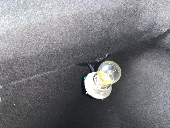

    • Open the trunk of the vehicle.
  2. 2011-2017 Hyundai Accent Brake Light Replacement: step 2, image 1 of 3 2011-2017 Hyundai Accent Brake Light Replacement: step 2, image 2 of 3 2011-2017 Hyundai Accent Brake Light Replacement: step 2, image 3 of 3
    • View the side flap for whichever side has the dead bulb. (This is the left side view.)
    • Pull the flap up and locate the brake light.
    • The flap may need some extra force to open because the cutouts are typically not cut all the way through.
  3. 2011-2017 Hyundai Accent Brake Light Replacement: step 3, image 1 of 2 2011-2017 Hyundai Accent Brake Light Replacement: step 3, image 2 of 2
    • Twist the socket counterclockwise to gain access to the brake light.
  4. 2011-2017 Hyundai Accent Brake Light Replacement: step 4, image 1 of 2 2011-2017 Hyundai Accent Brake Light Replacement: step 4, image 2 of 2
    • Push down slightly and twist the bulb counterclockwise to remove the dead bulb.
    • Pay attention to the protrusions located on the bottom of the bulb. You will need to align these protrusions with the socket when inserting the new bulb.
  5. 2011-2017 Hyundai Accent Brake Light Replacement: step 5, image 1 of 2 2011-2017 Hyundai Accent Brake Light Replacement: step 5, image 2 of 2
    • Insert the new bulb into the socket and twist the bulb clockwise to secure it into place.
