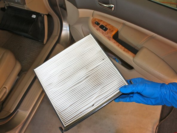

  5. 2003-2007 Honda Accord Cabin Air Filter Replacement: step 5, image 1 of 1
    • Push the air filter out of the plastic housing from the bottom and discard.

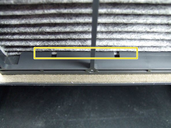

  6. 2003-2007 Honda Accord Cabin Air Filter Replacement: step 6, image 1 of 2 2003-2007 Honda Accord Cabin Air Filter Replacement: step 6, image 2 of 2
    • Orient the new filter properly, with the air flow arrows (located on the filter) aligning with the indication on the filter tray assy.
    • Press the air filter down into the housing while draping the filter's thick side pleats into the plastic housing.
    • Ensure that the last vanes on the front and back of the filter fit into the retaining tabs in the filter tray to prevent any particulates passing around the filter.
