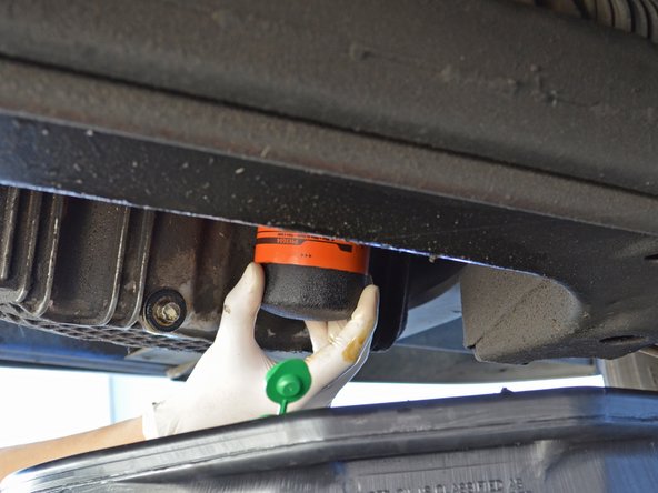

  8. 1995-1999 Dodge/Plymouth Neon Oil Change (SOHC): step 8, image 1 of 3 1995-1999 Dodge/Plymouth Neon Oil Change (SOHC): step 8, image 2 of 3 1995-1999 Dodge/Plymouth Neon Oil Change (SOHC): step 8, image 3 of 3
    • Wipe down the threads for the oil filter to remove any oil or debris that may have collected.
    • Keep the new oil filter facing upwards to prevent any spills and place it over the threads.
    • Tighten the filter by rotating it clockwise until it is snug. Do not over-tighten the filter.

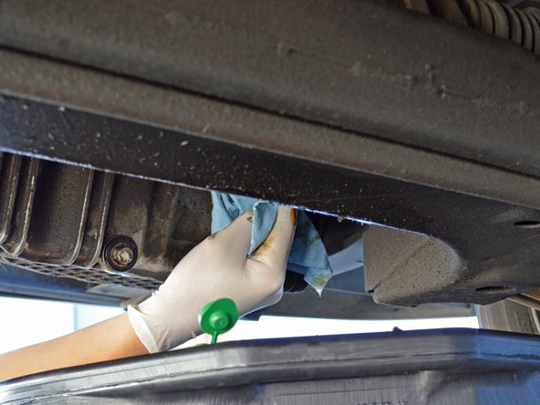

  10. 1995-1999 Dodge/Plymouth Neon Oil Change (SOHC): step 10, image 1 of 3 1995-1999 Dodge/Plymouth Neon Oil Change (SOHC): step 10, image 2 of 3 1995-1999 Dodge/Plymouth Neon Oil Change (SOHC): step 10, image 3 of 3
    • Once the draining slows to a drip, use a rag or towel to wipe away any excess oil or debris from the oil drain plug hole.
    • Wipe down the oil drain plug, reinsert it, and tighten it with your fingers.
