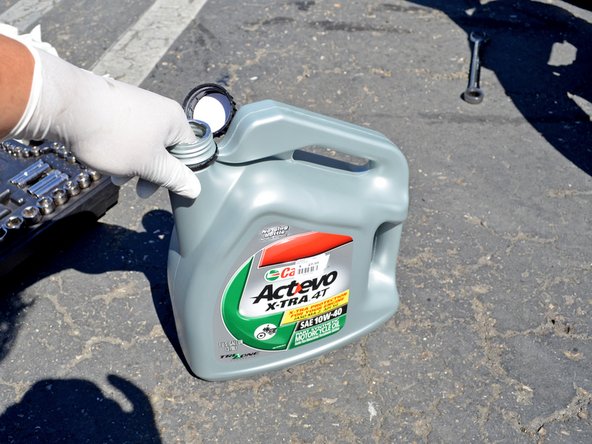

  • Engine Oil - Quart (4) , 10W-40 Make sure the oil is for motorcycles.

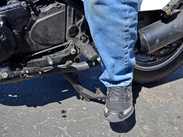

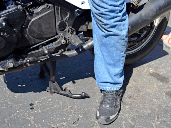

  • If your bike has a front lower cowling, you must remove it to perform the oil change.
  • Begin by locating the center stand peg. It is located behind the the left foot peg and just below the exhaust pipe.
  • Mount the bike and raise the kickstand.
  • Use your left foot to apply pressure to the center stand peg and rock the bike backwards onto the center stand.
  • If you have a fork and swing arm stand, you may use these to raise your bike instead of the center stand.

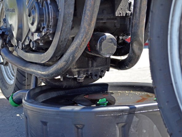

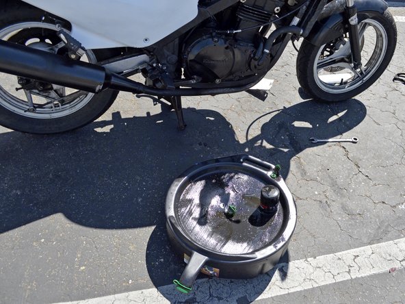

  • Locate the oil filter and 17 mm hex oil drain plug. The oil filter is facing forward off the front of the engine, along its center line. The oil drain plug is on the bottom of the engine, below the oil filter.
  • Place the oil drain pan under the oil drain plug and oil filter.
    • Be sure to position the drain pan so that it will catch the oil when it is streaming out of the pan.

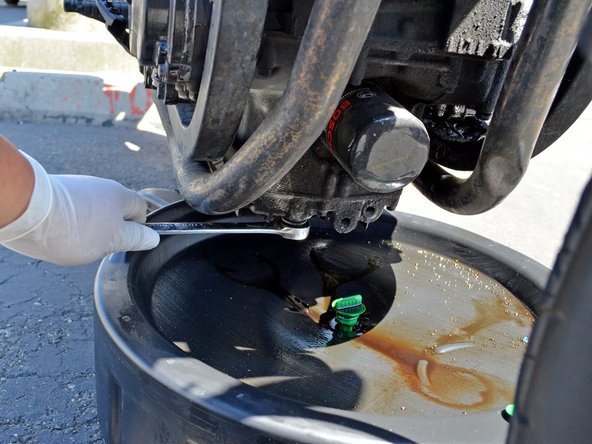

  • Always wear protective gloves and eyewear when working with motor oil. Be careful if your bike has been running recently as the engine and exhaust may be very hot. Keep rags or towels nearby to wipe up any spills.
  • Use a 17 mm box end wrench or socket to turn the oil drain plug counter-clockwise until you can turn it by hand.
  • Finish removing the oil drain plug by hand and allow the oil to drain. Loosening the oil fill cap either before or after removing the drain plug will help drain the oil faster.
    • Watch the draining oil for shiny specks. These specks may be metal flakes which could indicate a serious problem with your engine.

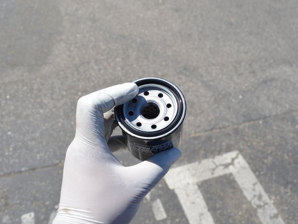

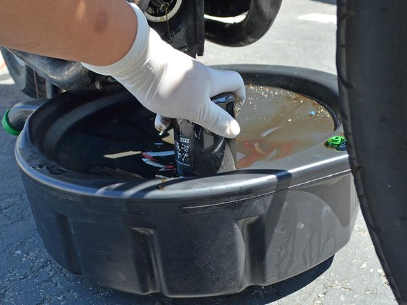

  • Remove the oil filter by turning it counter-clockwise by hand.
    • If the filter is too tight to loosen by hand, use an oil filter wrench. A wrench that fits over the top of the oil filter is ideal, as there is very little space on the sides of the oil filter.
  • Place the oil filter in the oil drain pan with the threads facing down.

  • Wipe off all the oil from the engine's oil filter gasket face and threads using a clean rag or towel.
  • Put on a clean glove and dip your finger in a new bottle of oil.
  • Spread clean oil around the entire gasket of the new oil filter.
    • Wipe off any excess oil from your hands/fingers when you are done as the oil may make handling the filter or tools difficult.

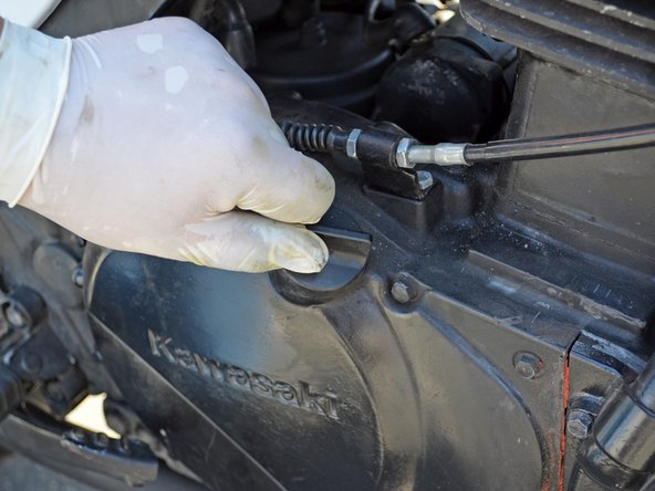

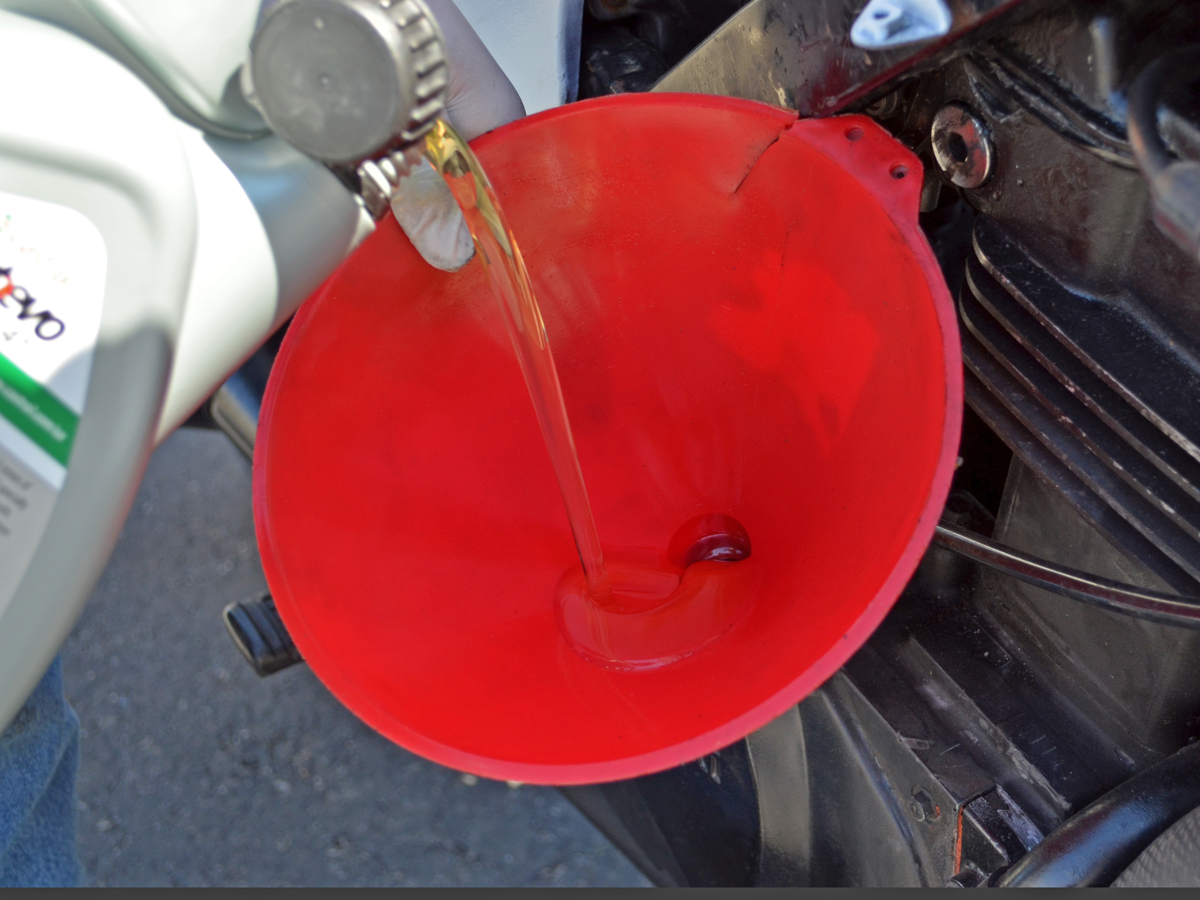

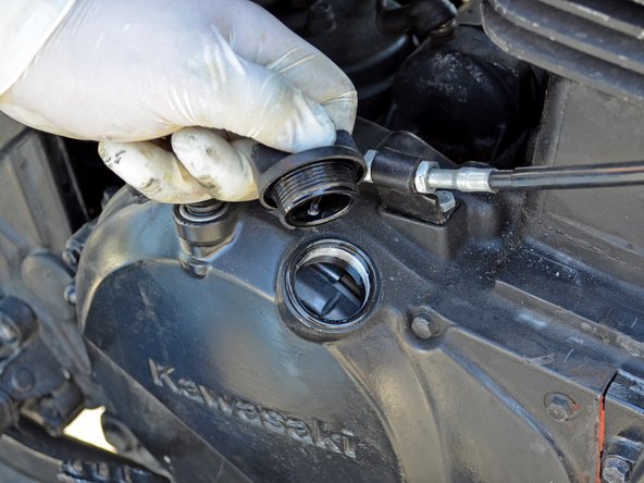

  • Locate the oil filler cap. It is on the right side of the bike, on top of the clutch cover.
  • Remove the oil filler cap by turning it counter-clockwise until you can pull it away from the clutch cover.
