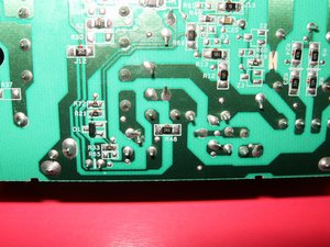

SMD resister blew out. Want to replace but can't identify.
History
I don't know if anyone could help me with this but I got to try anyway.
I have a transformer the stopped working, it had a fuse that was dead that I already changed and this small smd resister which seemed to pop from the mark it left on the case. I want to try to replace the SMD, but I don't know which kind it is since the number is all burned off. so I'm posting this photo showing which one it is in hope of someone being able to tell me which SMD to put there.
Thanks in advance

Finalpaladin, what printer are we looking at and which board is it? Is that a R48 just below the resistor? It MIGHT help to see the other side as well.
oldturkey03,
the printer is an HP Officejet 6500. the board itself is the transformer (AC adaptor) of it's power cord. The resister is indeed R48 . I added the photo up above of the front. The fuse I switched already is the one visible on the upper left side corner if it helps.

Okay, looking for parts diagram of a HP 0957 2271 AC Adapter for you :-)

Finalpaladin, I just opened my HP 0957 2271 AC adapter. The resistor on R48 bears the marking 2R4 on it. This of course cross reference to a 2.4Ω resistor. You can get these at places like this. Not a bad price compared to a new AC adapter ;-) Hope this helps, good luck.
Thanks a bunch man. I'll let you know if it works ^_^ And thanks for the link. I'm going to buy it downtown, but this is awesome for stuff I can't find. Thanks a whole bunch
