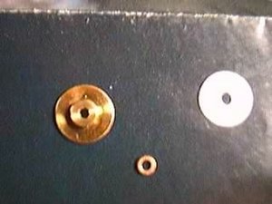

So let's # the rings so we won't get lost, and I would be referring to it as #'s
1->small brass ring
2->brass saucer
3->plastic

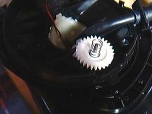

If you were to examine the kinect, you would notice that there is an opening along the base, assuming you have already removed the plastic cover and your on the metal plate with 4 #0 screws, one is an opening for the wire that connects to xbox and the other one is for a side which exposes a gear.
Examining further, you would notice Hexagonal Screw head which underneath or on the other side is a female nut (meaning a bar is to go through), so with the data we have already collected it is enough or almost safe to say that the rings are to be placed on top of the exposed gear so it should be like these;
2
3
Spring
Gear
a little visual;
1 __
2 __
_|__|_
3______
Spring
Gear
So using a screw to help you keep holding the rings in place, you can place back the gears and the plate without any trouble.
There is a caveat though, never ever let go of the plates from being held down while placing everything in place, if you do, I think you're done, also work in a place where there is good lighting and minimal to none crevices so just in case you've accidentally release the rings from being held, you'd still be able to find it.

Any chance you can take a picture of the components and the approximate location that they came from and post them up here? You can use the images tab in the lower left corner of the window.
