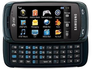

Calibration is off, can't get into menu/contacts/dial
History
Side menu bar works on touch screen, except for as mentioned. Therefore I can not calibrate the screen. Keyboard works, calls can be placed.

Andrea. if I remember right you can try the hard reset code *2767*3855#. That should bring the Calibration screen up. Please remember that ANY hard reset WILL ERASE ALL YOUR DATA Here is a great Forum with all kinds of ideas about your phone. Good Luck.

I know this will sound silly but it works. There is a grid under the touchscreen that is held in place by glue. Over time the glue starts to separate from the screen and the screen becomes non-responsive.
Here is the simple fix. You need to re-heat the glue so it sticks to the grid. Here is how you do it. First remove the battery and sim card. Next you'll need a toaster oven. Now looking inside the toaster oven, look for the heating elements (bars) inside at the top of the oven. Be sure to place your phone FACE DOWN over a napkin on TOP OF THE OVEN (NOT INSIDE) so that the phone is centered evenly over the heating element. Turn on the oven at 450 degrees for 10 minutes. IMPORTANT!! Let the phone cool off FACE DOWN FOR TEN MINUTES before you re-install the battery and sim card. The reason being that the now heated soft glue will need to cool down and reattach itself to the grid and touchscreen. If you don't center the phone correctly, you'll notice that only one side of the touchscreen will work. If this happens, no worries, you can do this again till you get it right.

Sam Silvestre, thank-you for your answer. I read your solution, and did the lazy man's thing: Took the battery out and heated the phone with a hair dryer, let it cool down, and now I can use my touch screen. Screen was not working for 24 hours. Thank-you so much!!!
