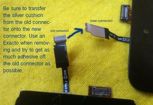

After you remove your old screen look on the tip of the thin video cable and you will see what looks like a little aluminum/mesh cushion pad. Some manufacturers are shipping replacement screens without this pad and without it you will get a white screen.
Carefully use an Exacto to scrape the old one off, try to get as much adhesive as you can when your working and note the orientation and which side the adhesive is on. Place the cushion on your new screen and hook it up.
I got a dozen screens in from a manufacturer and was scratching my noggin thinking why is the old screen working and all the new ones white when I discovered this little nugget. :)

@phil, here is a photo to clarify.

I plan on calling them tomorrow, dunno if it makes a difference, but in this photo you'll see on on the left is the connector for the new screen which leaves me with a white screen and the right a connector from an old screen which works fine. You could be having the same issue.

John, that would be a great fix. Do you think you could post an image with your answer?
by
@oldturkey03 just closed up shop at 4am about an hour ago, I'll post a pic either this afternoon or Saturday afternoon when I'm back at work.
by
I started a discusson about what parts to move over from the broken screen:
What parts to move from the broken screen? and wanted to comment on this bracket thing as It always is a hassle transferring without bending it/losing glue etc. @Garry suggested to leave it and after many repairs i agree. Just be sure to cover all contact areas with the 300SLE adhesive. I now get perfect contact every time.
Thanks for pointing out the pad and for the photo @John. I just pinch this pad off the old screen and it stays sticky.

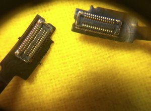

I would agree with all the solitions above. Always try the reset , re-seating lcd connector options first.... And of course if you swap the screen and a new one works then of course you know the first screen was faulty.
IF ALL of those things fail and you know the screen itself is not faulty then one thing that worked for me was:
Using a magnifer (20x binocular if possible) look at the area to the right of the lcd connector on the mother board - with the lcd itself disconnected. There should be a row of tiny components in a vertical line between the right hand side of the connector and the ambient light sensor (the one with the foam sponge around it). The 2nd component up should be a little black resistor. I had accidentally knocked mine off whilst prying up the lcd connector.
I bridged that missing resistor by applying some solder across the 2 pads and when then lcd was re-connected the white screen was fixed. That was a year ago & the ipod has worked fine since. Ideally you would get a resistor the same size & resistance , but I didnt have access to smd reworking-type equipment. So far so good!
You definitely need that magnifier-preferably stand mounted so you have 2 hands free to do the soldering underneath.

This is not a problem with the digitizer but the LCD connector. Check if it damaged like mine was where a pin was gone of the connector:
https://www.dropbox.com/gallery/943721/1...
Look at the picture LCD_connector_ipodtouch4g.
I also had a similar problem when exchanging 3 screens did not give me any picture. This iPod Touch 4g I gave up and was in my drawer for 3 weeks. I one day connected it again just being bored and voila, it worked again. Very spooky but it has since worked perfect. I know this may be of no comfort but miracles can happen. This Touch 4g is a spooky thing...

The cushioned sticker missing under the contact could be a problem. I once put it back on again and solved the white screen. Worth a try. I guess you read all the other good advice here. This Touch 4g will forever be our nightmare. I stopped fixing them because they are really voodoo. I fixed one and got the white screen but could not fix it. 2 months later I pull it up from my drawer and turn it on - it worked perfect again! Now that must be voodoo!

Just FYI the mesh pad doesn't matter. I've been repairing these for a couple years and have done hundreds and I have NEVER, literally NEVER transferred that piece and have never had a white screen issue
by
Thanks for the reply. I shall try replacing the cushion and go from there. I myself have said I won't be touching these again. Not worth the hassle. I hope the same happens with this one in a couple of months too! Thanks again

Could very well be a bad seated digitizer connector. It is the one deepest under the plate so you would have to open everything up again. Be careful to transfer over the small little sponge to the cable as it puts pressure on the connector and keeps it in place. Could of course be a bad digitizer, but 9 out of 10 times when I have lines, half picture, half responsive glass etc. I reseat the connectors and also use contact spray on the connectors.
by
Thanks for suggestion. It worked after installation. Just noticed now that front camera does not open. Any hint for solvi g it? Thanks

What helped me was taking out the screen (again) and disconnect the two connectors,(put on the little rubber on the digitizer) then to make sure the lcd connector is 100% inlined I connected that one before putting the heat shield and the screws back on, Its a little harder dealing with the 90 degrees upstanding screen you need to hold still or let rest against a stander, but it ensures a good connection between the connectors, and waaaaay less changes of white screens.
