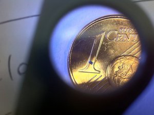

This is a great thread, I'm having the same problem, but neither my service, wifi or Bluetooth are working, I'm going to try this tmrw and I will let you guys know how it goes. Keep up the good work, best info I've found after searching the web for nearly 2 days :)
P.s. my little blue inductor seems to be ok, so am gonna do a full tear down and build it back up first, to see if the problem can be solved without messing with the inductor. Wish me luck :)

I myself am having a hard time getting the iphone 4 back up and running. I replaced the bottom black portion which contains all of the parts needed for reception. I still cannot get service, I got service for 3 days and then went to searching and no service repeating. I replaced again and got a brief 3g symbol which disappeared quickly. I have cleaned all contacts,from oily fingerprints/smudges. the cable that connects to the board is connected as well. along with the the little blue fuse intact which ive read causes issues if knocked off.
Please help!
