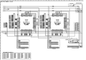

What are the four black chips on the mobo.
Right below the GPU and CPU. Can some one tell me what they are and what they do? Their are four on the back too.

ericambrose32, those a memory IC's. They are EDX5116ACSE and are a "512M bits XDR™DRAM organized as 32M words X16 bits. It is a general-purpose high-performance Memory device suitable for use in a broad range of applications." Hope this helps, good luck

ericambrose32, it would really help if you post an image. I have a feeling I know what you are looking at, but hate to guess.
by oldturkey03
http://i70.photobucket.com/albums/i120/S...
The two below the RSX and the two below the Cell BE.
